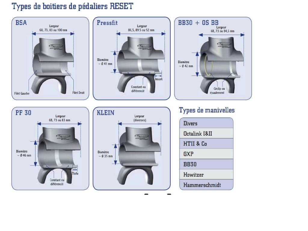

Posts: 8,419
PostPosted: 11/05/2013 09:54:04    Post subject: Largeur boitier de pédalier Reply with quote
http://reparbikes.com/
Joined: 06 Oct 2010
Posts: 5,421
PostPosted: 11/05/2013 11:16:23    Post subject: Largeur boitier de pédalier Reply with quote
Le top ça Pilou merci Smile
